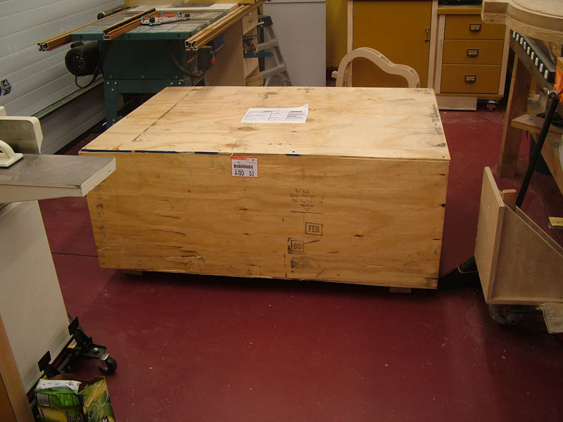

A Big Yellow truck showed up today and delivered this to the shop:
Hmmmmmmm wonder what it can be???
Let's get the drill and find out......
I can't believe it, it's FINALLY here!!!
Stupid box, where's that hammer....

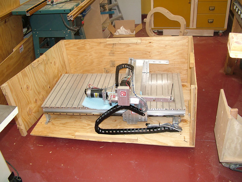

That's better, now we can load it onto the table and take stock....
That looks good, thank god I made the table a little bigger than I needed, this thing is heavy...

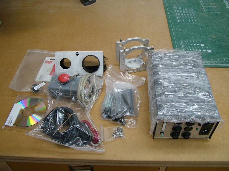

Here are all the parts:

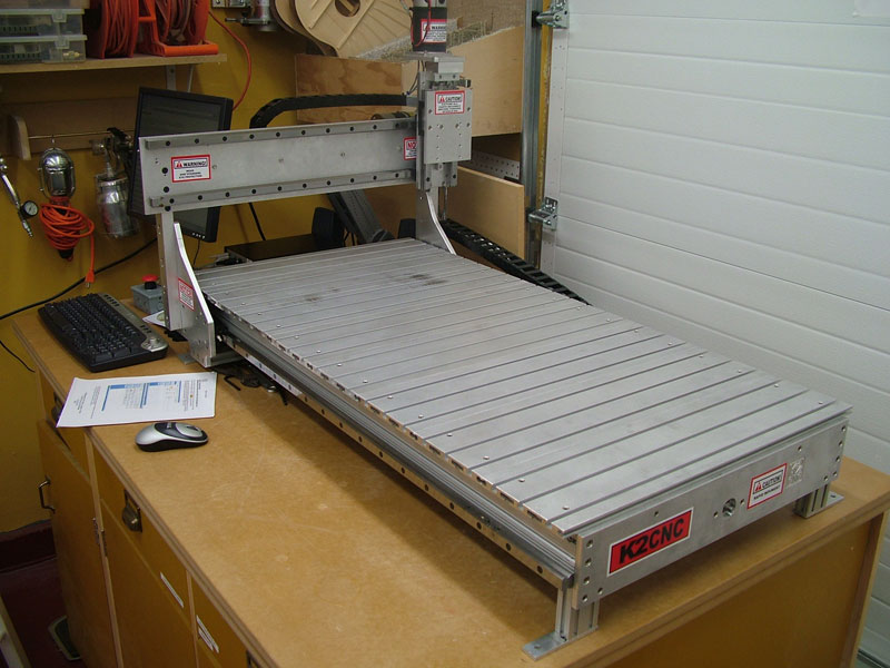

There's no instructions but I pretty much know what needs to be done, so off I go... Didn't really run into any big problems, everything was tight. I just had to lift the Z-Axis bar and bolt it in and then bolt in the wire track, total time about 30 minutes.

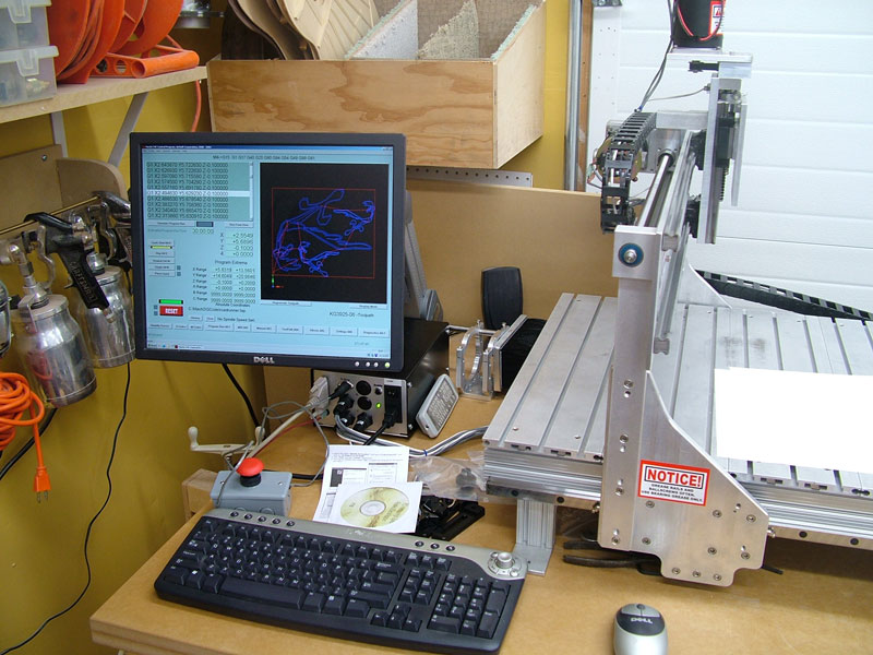

So here's where this gets funny (well kind of)..... I start hooking up the controller for testing, I ask some questions and K2 is very responsive. I finally go to plug it into the Dell and guess what?? NO FLIPPIN PARALLEL PORT!!!
Dang Dell morons (sorry Dell lovers), they can't even put a standard IEEE parallel port on the flippin computer so I call a bunch of shops and finally find one that carries a high speed port that has all the right features, $23 bucks later and I'm ready to.
Here's what it looks like:
They have instructions but to be honest they are for people who have done this before so I'm a little lost but I putter through and finally I can run the one demo program and the machine works. I figured out how to set the Zero for X,Y and Z...

I have not hooked up the router just yet, I want to make sure I understand and can control the machine first, if I can make a drawing and not destroy the pencil then I'll be ready, little steps . I also want to hook up a little control panel so I can kick on router, and dust collector from the keyboard. Not sure how to do that just yet but I'll figure out something. I also need to play with the quick change chuck I bought for the router, there's just so much to figure out on this, it's going to keep me busy for a while
They provide MachII for the controller software and once I figure it out I'm going to go up to MachIII as it has some nicer features. They do have scripting in this version so I'll do some things like add a home button to home the machine and little things like that. I spent a week in Seattle last week taking a Rhino Cad class at their headquarters, it was money well spent, now I just need to figure the machine end out and I'll be jommin mon!!!
